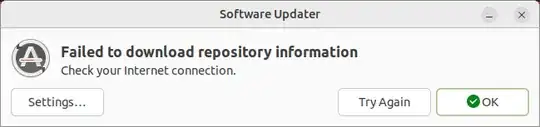

Running 22.04 on a MacBook Air and all is fine and dandy, but for one tiny quirk. On a daily basis I engage the "Software Updater" application and always get the application response, "Failed to download repository information check your internet connection." In actuality, repository information IS downloaded and ready to install and I proceed with the installation. I am an unsophisticated user and do not know where the Software Updater application goes to find information. All I know is that nearly every day I do get something to install or update. The amazing coders in Ubuntu-Land have even sorted an issue with my internet connection dropping and then picking up again, via assorted recent updates.
The question is, why does "Failed to download repository information" always display, even when there is something to download or install?
What's the problem?
Software Updater
The message "Check your Internet connection." is unhelpful. The application can (and does) check your Internet connection and, obviously, (since the update ultimately works) your Internet connection is fine. This message is a low-effort way of saying that they ran into some, unspecified, problem reading from one or more of the configured repositories. But, as you've seen, it does not necessarily mean that the download failed completely.

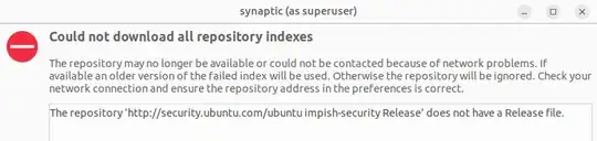

Using other tools, such as the 'Synaptic' graphical package management tool (available in 'Software Boutique') you can get more information. For example, with Synaptic, I currently get the following response when attempting a 'Reload' (Note: A similar, but less descriptive, message is available when updating from Software Boutique itself):
synaptic
So it seems that my system (Ubuntu MATE 22.04) has a reference to archives from the now-defunct [21.10] 'impish' release. But even the above message confounds the problem since it's saying "does not have a release file" when, in fact, that repository does not exist at all (due to rollout of the EOL).

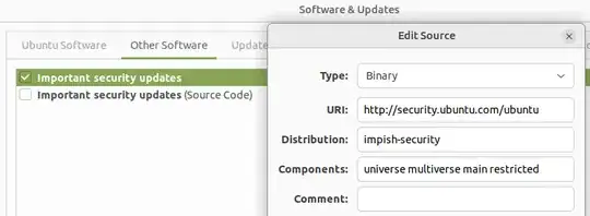

The 'Software & Updates' dialog (accessible by clicking 'Settings...' in the Software Updater) is where repository locations are configured. In my example, this includes the configured reference to the defunct 'impish-security' distribution at http://security.ubuntu.com/ubuntu. [It's interesting that this isn't using 'https'.]
Software & Updates
So what's the fix?
If your case is similar or analogous to my example, the quick fix is to disable the offending software source that is listed in the 'Other Software' tab (shown above). Once this is done, Software Updater will stop complaining about this.
Alternatively, if you happen to know of a new (and still secure) location of the repository, you could change the URI (and/or Distribution) to specify that.
