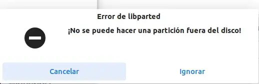

Hi i want to upgrade my main system from Ubuntu 20.04.4 to 20.04.1 LTS. But when i open gparted i get an error message. In spanish but i think very self explanatory:
Error from libparted: can't have a partition outside the disk

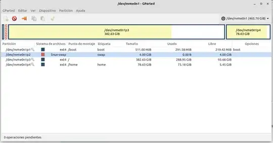

But i failed the upgrade because lack of free space in /boot, ubuntu told me that i had to free at least 350 mb on /boot....But i dont have such free space, and deleting one kernel could not be enough. So i need to resize partitions, adding for example 500 mb to /boot and ideally take it from / . But i have /swap partition in the middle...So whats the best option to get more space in boot, perhaps deleting swap partition ?
I add the screenshot. enter image description here
For sure i need all the information and i cant format the partitions and loose the information, software, configs in them.
Id like to have some kind of tutorial of what to do. Perhaps this could be a bug in upgrading process, because it should delete old kernels and install the new one.

First, make sure that you have a tested backup of your data. Never touch your partitions without a backup of it. Or you may regret it !!!
Then you can turn off your swap
  1. disable swap
    sudo swapoff -a
  2. keeps the swap off during reboot (Just in case you reboot your system before the end of this procedure)
    sudo sed -i.bak '/ swap / s/^\(.*\)$/#\1/g' /etc/fstab
  3. Remove the swap partition using gparted
  4. Extend your /boot partition using gparted
  5. Recreate the swap partition with the size left and set it as swap using gparted
  6. Restore your old fstab
    sudo mv /etc/fstab.bak /etc/fstab
PS: I didn't test the solution, but this is what I would do.

1 - Boot computer and disable swap
sudo swapoff -a
2 - Open gparted or Disk Admin to manage partitions.
3 - Unmount /boot partition.
4 - Unmount swap partition if its still enabled.
5 - Delete the swap partition.
6 - Resize the /boot partition by the right ("taking space from swap partition, reducing it). In my case i increased /boot till 1024mb and left swap with 3.5 Gb
7 - Apply changes.
8 - Take note of /swap partition UUID.
9 - Open with gedit or whatever text editor /etc/fstab and in the line where describes the /swap change UUId to the new UUID the partition has. Would be nice to make a copy of your fstab before just in case....
10 - Reboot and pray... ;)
