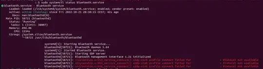

Finally I found out, where I can see the actual problem. It was becouse of a2dp-sink profile failure enter image description here The solution I found here a2dp-sink profile connect failed. The answer form Marko.
