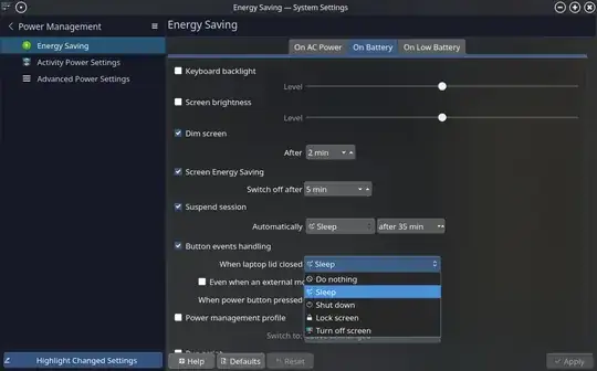

In the Plasma settings the default is sleep/suspend when lid is closed, and there is no hibernation option:
