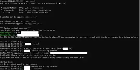

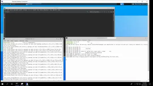

Screenshots (redacted for confidentiality):
  1. App running with RDP session What you can see: Open RDP session, App running in background (behind terminal, not as background process), Terminal 2 started the app by calling 'app.sh', Terminal 1 sent a 'list ui' command to the app. All works fine
  2. SSH connection, attempting same commands as previously (remember, no PHISICAL display / no desktop screen available in production
What can you see: an open SSH connection, attempting to call same 'app.sh' as before.
