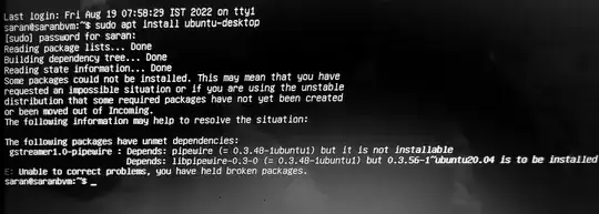

enter image description hereUbuntu cannot login Graphical User Interface. when try to install
sudo apt install ubuntu-desktop
Says some packages could not be installed. The following packages have unmet dependencies gstreamer1.0-pipewire : depends: pipewire(=0.3.48-1ubuntu1) but it is not installable. E: Unable unable to correct problems, you have held broken packages.
I uninstalled pipewire and that dependencies.
Startx
Also not working
For more information check this image.
Here it is how I solved this problem
I manually edited the status file using nano
sudo nano /var/lib/dpkg/status
and removed pipewire Ubuntu 20.04 dependencies paragraphs and saved
Note, I'm not remove packages
then
sudo apt update
sudo apt upgrade
now I can log in Graphical User Interface
