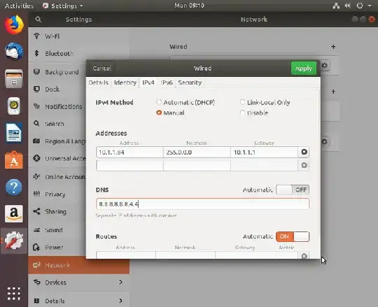

Your netplan file refers to Network Manager. I suggest that you revert netplan to its default:
# Let NetworkManager manage all devices on this system
network:
  version: 2
  renderer: NetworkManager
Next, set your static IP address and DNS in the Network Manager settings:
Reboot.
