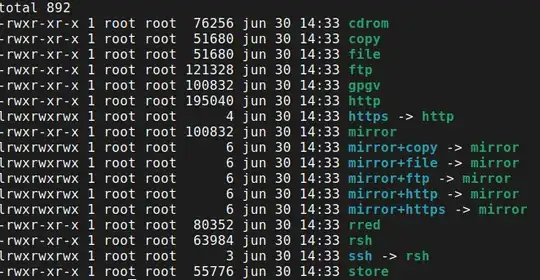

This is what i get when I type: ls -l /usr/lib/apt/methods:
I can't see any "hyyps"!
