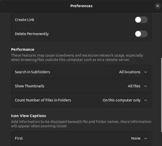

It's also enabled in the GUI preferences: Nautilus preferences

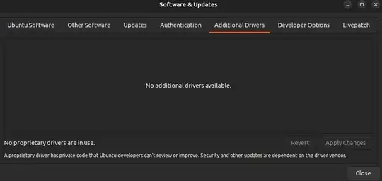

I am using an AMD CPU and an AMD GPU, using open source driers installed using the install script from AMD's website: enter image description here
