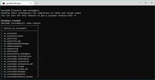

Nextcloud database: in the MariaDB/MySQL step, I found I had no database called "nextcloud" but there was one called "ncexample" which I thought was probably the one. A web search revealed that the Nextcloud database contains a bunch of tables prefixed "oc_" (Nextcloud being a fork of ownCloud), which helped to confirm that the db I was about to delete was at least some Nextcloud database on that server. In my case that was all I needed to know before deleting it.
