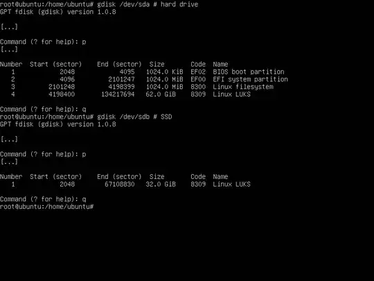

  • Use "gdisk" to set up the partitions so they look like this:tweaked gdisk output
    I'm not going to try to provide step-by-step instructions for operating "gdisk" here, but I will note that when it asks for the first sector, just press Enter, and when it asks for the last sector type "+" (very important) followed by the size, e.g. "+1M" or "+1024M", or just press Enter to use the rest of the disk.

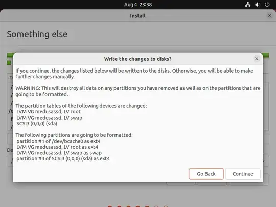

  • Click "Install Now"; in my case the confirmation screen looked like this: installation confirmation screen

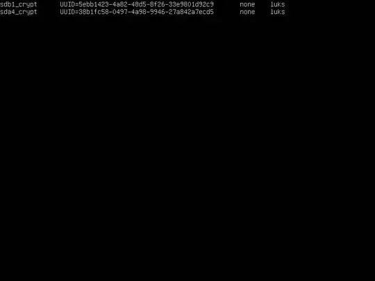

  • Create /etc/crypttab with those UUIDs in; because I don't think there's copy and paste available in this shell, we can use the /tmp/uuid file to avoid typing out the long UUIDs by hand, but you can obviously do this however you like:
    vi /etc/crypttab
    :r /tmp/uuid
  • Edit /etc/crypttab to look like this screenshot, but with your UUIDs:/etc/crypttab example
