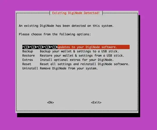

I have created an installer bash script for setting up a DigiByte full node via the linux command line. It works fine in Raspberry Pi OS lite 64-bit on the Pi 4, but if I install Ubuntu Server 64-bit LTS on the Pi (arm64) I am getting intermittent issues with the whiptail dialog boxes not working. When it reaches a menu I am unable to navigate or proceed - pressing return or the arrow keys prints strange characters to the screen. Scrolling with my trackpad also spits out strange characters. Strangely, if I Ctrl-C out of it, and then manually run the same whiptail menu command directly from the command line it works fine.
I have tested the issue over SSH from both Mac (iTerm 2) and Win10 (Putty) and get the same issue on both systems. However, I also have experienced the odd situation where it seems to suddenly work normally - the problem seems intermittent. That said I have recently encountered it again and no amount of rebooting or trying different terminals seems to solves it. I should also add that I have just tried it with Ubuntu Server 64-bit on a PC laptop (x86) and it works fine, and I can navigate with the keyboard without issue.
Can anyone explain what is likely causing the issue, and how to solve it?
Whiptail menu not responding to key presses
Fixed with stty sane 2>/dev/null || true before calling whiptail.
