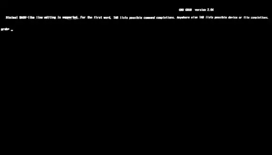

I am a new Linux user. I am facing problem in booting my PC when I installed Ubuntu 20.4 along with Windows10 dual boot. Now when I start my PC there is GNU Grub page opens with this message: Minimal BASH-like line editing supported.
I have already tried Boot-Repair through a live USB, but it did not opened the Boot-Repair option for my PC, therefore I couldn't my grub this way. I am also providing the Boot-Repair Boot Info Summary here for your reference.
