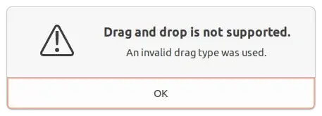

I use web.whatsapp.com under Firefox with ubuntu 20.04 and I think it is not ubuntu related but web.whatsapp itself that causes the issue. When I try it, the error report is
Drag and drop is not supported an invalid drag type was used
but right clicking the image in whatsapp and copy/paste works fine
