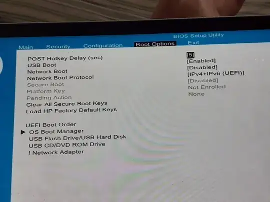

I also disabled Secure Boot from my BIOS settings.
BIOS Boot Options:
BIOS Boot Options (shows that Secure Boot is off)

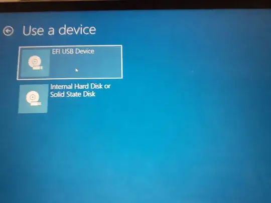

I then rebooted my laptop from the USB using the "change advanced startup options" of windows, I will include the steps below:
booting from USB part 2
(I chose the "EFI USB device option")

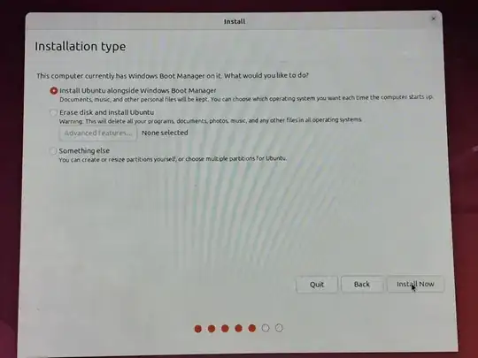

I then chose the "Install Ubuntu" option and chose normal installation. When asked where to install Ubuntu, I chose the Install Ubuntu alongside Windows Boot Manager option:
installation type page

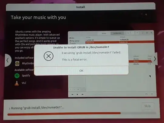

The installation started and the progress bar was filled until near the end, when I got this Error: Unable to install GRUB in /dev/nvme0n1: executing 'grub-install /dev/nvme0n1' failed. this is a fatal error.
Picture of the error message
I was asked to restart the computer, after which windows was loaded.

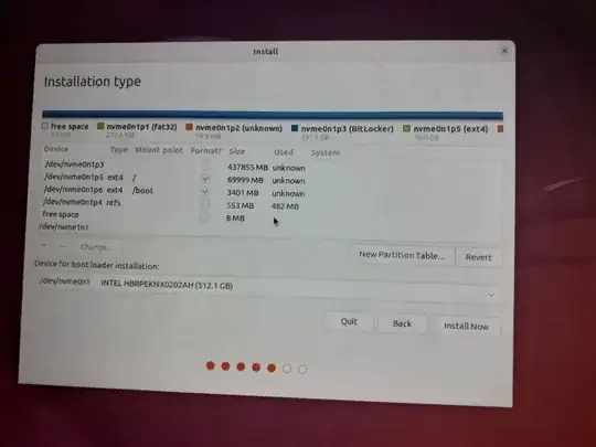

  1. I chose the "something else" option on the installation type and mounted 3 GBs as the /root directory and mounted the rest of the free space I had created on windows as the root (/) directory. the rest of the options were left unchanged, this is a picture of the partitioning screen.
partitioning page
After trying to install, I got the same error as before, but Ubuntu was installed on my drive as the next time I tried to run the installer, I was given the option to Erase and reinstall Ubuntu.
