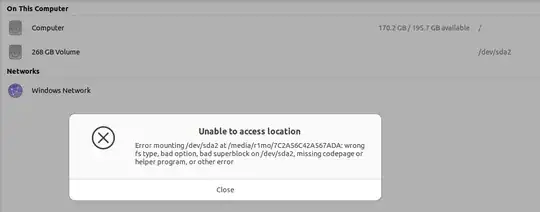

this is what I see in the file explorer: file explorer after clicking the windows volume

Windows usually boots in UEFI mode but if you have an old installation that has been gradually upgraded to Windows 10 it can boot in the original legacy mode. Judging by the position of your EFI partition you have just installed Ubuntu in UEFI mode. They are not compatible. You need to get both booting in the same mode so if the Ubuntu install is very new probably easiest to reinstall Ubuntu in legacy mode.
