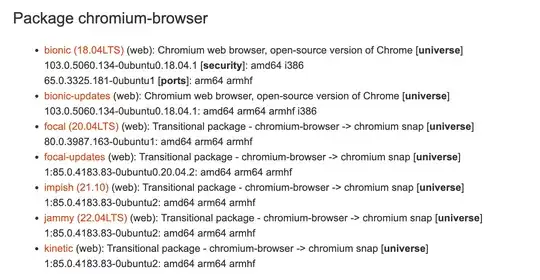

The chromium-browser Ubuntu 18.04 bionic-updates package lists not only the latest Chromium 103 (at the time of this writing) but also supports arm64 and armhf architectures. However, chromium-browser Ubuntu 22.04 focal-updates only contains a very old version of Chromium, 85.x
And by doing a package search, we can confirm only 18.04 contains the latest updates for Chromium:
Chromium browser package search
Additionally, the latest chromium-driver is only available on 18.04.
Ubuntu 18.04 is set to reach extended security maintenance in April 2023. Will chromium continue to be updated, or will the maintainer need to start publishing the updates in a more up to date repository? For instance, the Debian maintainers keep both Chromium and Firefox arm64/armhf up to date in Debian Sid.
And regarding Firefox on Ubuntu, the story is similar. by doing a package search for Firefox we see that the most up to date builds for the arm64/armhf architectures is only on bionic-updates. (Firefox is kept up to date for amd64 in other versions, but for arm architectures it is only up to date on bionic).

Here's an outline of the State of Chromium (arm64/armhf) on Ubuntu versions:
  • Ubuntu 18.04 - Chromium v103 - up to date, LTS
  • Ubuntu 20.04 - Chromium v85 - Not up to date, LTS
  • Ubuntu 22.04 - Chromium v85 - Not up to date, LTS

As of February 17th, 2023, Nathan Teodosio responded in the Ubuntu Launchpad Bug Report - Deb version numbering is misleading. Apparently, they stopped updating the transitional deb packages. Here is what Nathan has to say about this:
For Ubuntu >= Focal the transitional debs are frozen at the version number 1:85...
This might make one think[1] that it will install a critically outdated Chromium while it does not, because it installs the snap.
[1] https://answers.launchpad.net/ubuntu/+source/chromium-browser/+question/702591
And in Answers Launchpad, Manfred Hampl explains that the deb package installs a snap, which then installs the latest Chromium browser:
The "chromium" deb packages for Ubuntu focal and newer are dummy-packages that do not contain the software, but install the snap version. So there is no need to provide updates for these, because update management is happening in the snap store. Ubuntu's deb package always installs the newest stable version available in the snap store.
In short, just because the package says Chromium 85 doesn't mean it will install Chromium 85. It will instead install the latest version.
