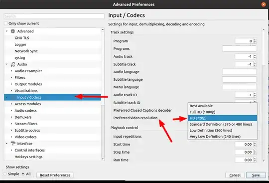

But how can I change the video settings from 720p to 480p or 1080p.

It's under Tools - Preferences
Here's an image of it
