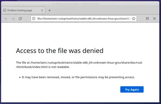

This results in an "Access to the file was denied" error in Firefox.
I assumed this was a snap issue, and asked in their forum. Got crickets.
So, I'm asking here. Maybe someone has figured out how to make Firefox open /home/me/.rustup/whatever.
Here is the output of snap connections | grep personal-files:
personal-files            firefox:dot-mozilla-firefox     :personal-files                  -
Here is a screenshot of Firefox telling me it cannot access the file...
Firefox error message

This does not work because the Firefox snap is not allowed access to ~/.rustup, which is a 'hidden' directory because it starts with a dot.
As a workaround, you can do the following to move the real location of ~/.rustup somewhere else. In this case we are moving it to ~/etc/rustup.
Execute the following in a terminal.
  1. mkdir -p ~/etc
  2. mv ~/.rustup ~/etc/rustup
  3. ln -s ~/etc/rustup ~/.rustup
Now rustup doc should work transparently.
