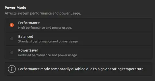

I followed the following Ask Ubuntu solution to display the options for enabling Performance mode in Ubuntu 22.04. However, in the Settings, Ubuntu tells me "Performance mode temporarily disabled due to high operating temperature." I don't understand why this error shows. My PC's temperature is normal. This error shows even mere seconds after turning on my computer, so it's not plausible. Is there a way I can tell Ubuntu to force-enable performance mode, just like with Windows?

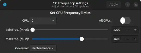

Looks like you're on the desktop version of vanilla Ubuntu 22.04. You can use cpupower-gui from the official apt repository.
$ sudo apt install cpupower-gui
enter image description here It let's you set the scaling governor either individually on each cpu or for all of them in one go. So you can just set it to Performance straight away and apply.
To run the program, just press the super key/windows key and type "cpupower" and lunch the program from the launcher. Alternatively you can lunch it from the terminal with.
$ cpupower-gui
Mine permanently docked on the launcher bar as a favourite.
