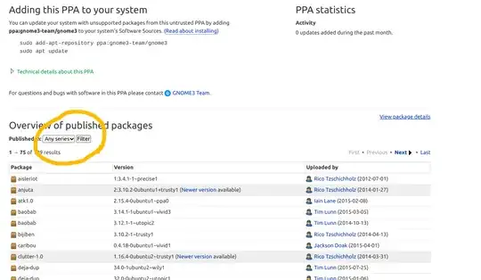

This ppa is out of date and has not been updated for any Ubuntu version newer than Ubuntu Bionic (18.04). You can verify this on the launchpad page (google the ppa name to find the launchpad page). Scroll down to where it says "published in" and click the dropdown menu to show the available release versions of Ubuntu.
