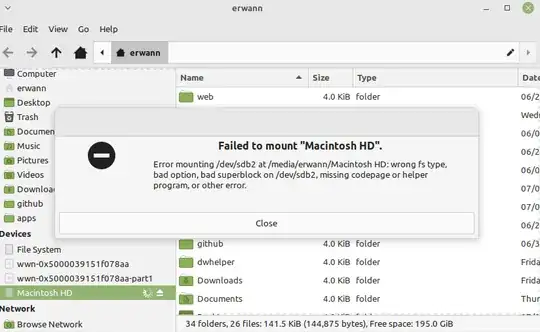

I'm trying to read (not write) the content of a HFS+ drive based on this post. It is automatically displayed in the file manager, but I'm unable to explore the drive. There is conflicting information as to whether it's mounted or not.
I have another problem that hinders my ability to experiment: eject is not responding, so what I do is unplug/replug the USB connector. But then it is not listed by lsblk and shows as 'No media' in gnome-disk-utility. The only way to get it mounted again, that I've been able to come up with, is to reboot. That is obviously tedious, so what could I do instead?

Other
I think El Capitan was the last OS on the Mac with which this drive was formatted so I think this rules out APFS.
$ apt list -a hfsprogs
Listing... Done
hfsprogs/focal,now 332.25-11build1 amd64 [installed]
This command hangs indefinitely:
$ sudo fsck.hfsplus -f /dev/sdb
[sudo] password:
** /dev/sdb

Try this:
Plug in the external HDD
Unmount the drive
Run:
 sudo apt update
sudo apt install hfsprogs
sudo fsck.hfsplus -f /dev/sdb2
Remount the drive
The drive is now read-write.

As @redseven points out in the comments of the answer, here's the important bit of your dmesg output:
[ 7619.684210] blk_update_request: I/O error, dev sdb, sector 0 op 0x0:(READ) flags 0x0 phys_seg 1 prio class 0
[ 7619.684222] Buffer I/O error on dev sdb, logical block 0, async page read
This likely indicates some sort of hardware failure. I would run a S.M.A.R.T. disk self-check on the drive. You can do this either with the smartctl command line utility (smartctl --help for the available options) or using a graphical utility. I recommend GSmartControl, but just because that's what I'm familiar with and it's pretty reasonable - if you find another tool you like better, feel free to use it.
I would first run a full offline check and check the overall health results. Then check for the attributes in this table, highlighted in red: https://en.wikipedia.org/wiki/S.M.A.R.T.#ATA_S.M.A.R.T._attributes
High levels of those values (as of July 2022) indicate impending drive failure.
