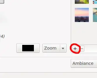

On a new box I had the same problem with a fresh install and a custom wallpaper that had all the correct permissions all the way up change of directories. I can't explain what was going wrong but what finally fixed the problem was when I set it as the wallpaper using the add (+) button in the Appearance dialog.
add button
