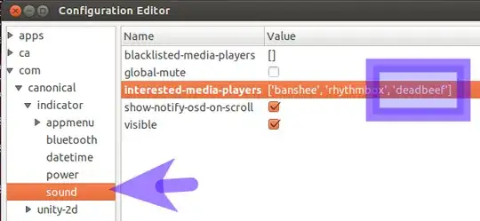

add deadbeef to sound indicator
Using dconf-editor you can add deadbeef to the sound indicator:

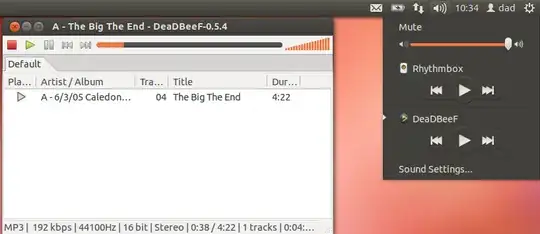

add volume control options
To add the volume controls you need to compile from the MPRIS plugin from source.
important note - this was highly unstable for me on 64bit ubuntu causing deadbeef to continually crash and I dont recommend you do so.
