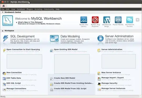

Mysql Work Bench Installation Completed.
