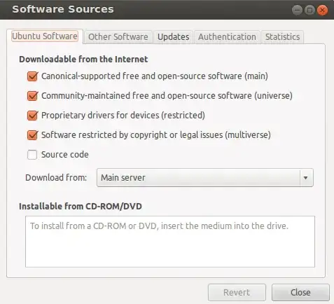

Using Ubuntu 12.04, I cannot see any update from my update manager. It gives me the message "check your internet connection"
bioShark
  • 4,315
Pablo
If you are able to use the internet, and your network is working, then try this: Open Update Manager, press Settings button and on te first tab, change the server where it says "Download from: ". I had the same issue, and for me it was automatically set to Germany. I selected Main server, and it's fine now:
