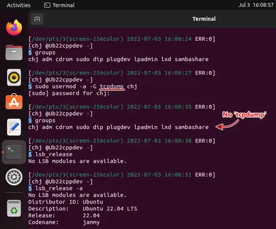

Execute the two commands, that is, adding current user to tcpdump group, then check the result by querying groups. BUT, groups does not report I'm a member of tcpdump why?
Screenshot from Ubuntu 22.04:
At this time, I checked /etc/group file, it has been added.
tcpdump:x:117:chj
In order to see tcpdump listed in groups command, I have to completely log out my desktop session then re-login.
How come it has to be so cumbersome? Am I missing something?

Try groups $USER to see the changes. Now, you are listing the groups for the current process, which may differ if the groups database has changed.
