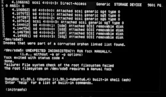

I was using my PC, I clicked to close the Opera browser and then clicked on LibreOffice Calc. After about 2 minutes Calc hadn't started so I clicked on the icon again. Once again after 3-4 minutes it still had not started, so I shut down the system using the on/off button as the on-screen controls were not working.
When I rebooted I just got the black screen below:

The computer says that /dev/sda5 has some inconsistency.
Run the command fsck -a /dev/sda5 to fix it.
