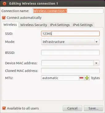

To make a wireless network available to all users we also need to tick the box "Available to all users" on the bottom left side of Edit connections -> Wireless -> Edit:
