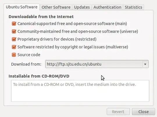

Often certain repositories loading painfully slow is just a symptom of using a slow mirror. The default mirrors for many regions are not the fastest (I know this is the case in China).
Changing your mirror is really easily done through the Software Sources GUI, you can open this window in two ways:
  1. Open Ubuntu Software Center and click on Software Sources in the Edit menu.
or
  1. Open a terminal (or type alt-F2) and run software-properties-gtk

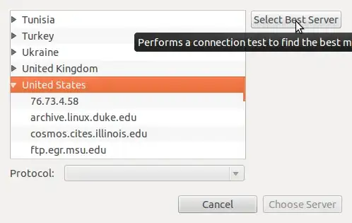

When this window comes up you'll notice a drop down menu saying Download From: that selects your mirror. Select the Other option from this menu.
softwaresources
In the new window that comes up click the Select Best Server button and this will test and automatically choose the fastest server for your location.
select best server
Hope this helps!
