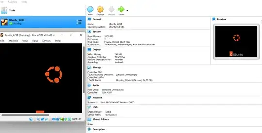

I have windows 11, and I downloaded virtualbox and installed Ubuntu 22 04. I followd this tutorial step by step.
Ubuntu finished installation without any issues, but when I try to run it, it seems to get stuck. I am including a snapshot below:
I have tried restarting my computer, but nothing seems to work. Can anyone help with the solution? Thanks in advance.

NOTE: Windows OS must have Hyper-V services turned off, as well as Windows Linux System. Screen will show the V-chip icon in grey if issues there.
Also, I had downgraded to 6.1.34 same prob, but didn't realize the Extension pack was NOT down-graded. I downgraded first to try with a fresh VM install using 20.04 64 bit, same thing Freeze/hangs, then as I downgraded I got Applicatino memory access errors.
Lastly, I downgraded BOTH virtualbox and extension pack to 6.1.30, still using 20.04 and problems seemed to go away, TBD, works but will test out more.. since I wasted a day of time !?!?
Why can't virtualbox have BETTER ERROR and config checking to tell you :
  1. Your extension pack doesn't match the version of VB A?? .. and/or:
  2. Tell you that Hyper-V services or Windows System for Linux is running ???
