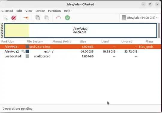

update 2022/06/23 I think it's something related to bios/EFI booting issue I didn't configure storage layout in user-data , just use the support layouts in documents
storage:
  layout:
according to the URL https://ubuntu.com/server/docs/install/autoinstall-reference
The two supported layouts at the time of writing are “lvm” and “direct”.
By default these will install to the largest disk in a system
but it didn't create any ESP partitions. this is the disk layout in VM after PXE auto install
I could add custom storage layout to add ESP partition , but in 22.04 , it's really a disaster to do so. I have to write many configurations for different type of hard drive. (/dev/nvme0n1 , /dev/sda , /dev/vda ) or otherwise the install process will fail.
