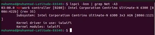

i just installed Ubuntu 22.04LTS for the first time, i conected to my wifi network and it's very slow, but then i conected to my phone hotspot and it was completly fine, then i conected via usb tethering from my phone via the same wifi network it was also fine.
I searched a lot, but i can't find anything.
can anyone help me?

I'd recommend that you delete the wifi connection, then re-connect.
nmcli connection delete <CONNECTION-NAME>
sudo systemctl restart network-manager.service
nmcli supports tab completion. You can find the connection to be deleted by pressing the tab
Then simply re-connect from the UI as you normally would.
