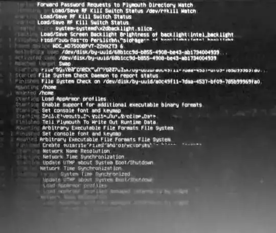

After waiting another few minutes I hard reset it again, then my laptop settled into the consistent behavior it displays now. Upon trying to boot, Ubuntu displays its splash screen, then, within less than a second, a few screens’ worth of text scrolls by. I'm fairly sure that it's typical boot-up diagnostic info and not relevant to my issue, but I managed to capture a moment of it regardless:
After displaying that text, the screen clears and I'm left with the message /dev/sda5: clean, 231273/1222992 files, 3947028/4882432 blocks and an unresponsive blinking underscore prompt. It may be worth mentioning that this message is different than the one I saw on first boot-up. The numbers were for sure different, but I don't know about the rest of the message.
