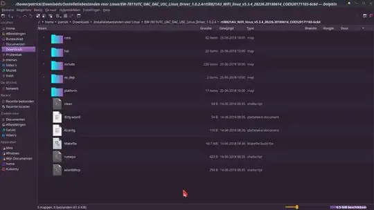

Got info from https://deviwiki.com/wiki/TP-LINK_Archer_T2U_Plus and downloaded the driver 5.3.4 from a link. The usb-id was the same. So now I have got a tar.gz file. I unpacked this. I have no idea how to install this driver. Content of the folder see picture.content unpakked tar.gz.

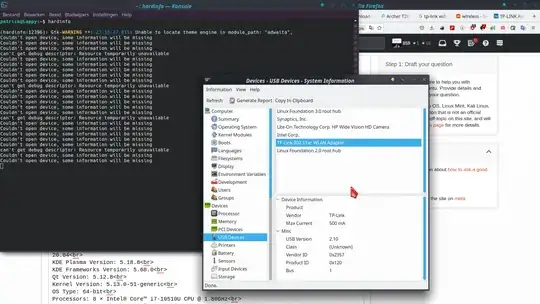

I have got this in hardinfo:product unindentified and class unknown. And 'can't open device' error in Konsole. See image.hardinfo tp-link Archer T2U

lsusb shows me Bus 001 Device 002: ID 2357:0120 TP-Link 802.11ac WLAN Adapter ( amongst others )..Systeminfo:
