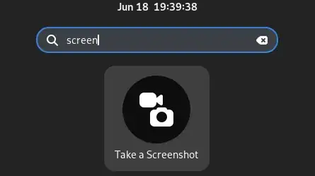

I'm trying to remove the shortcut to "Lock Screen" from the start menu, but I can't seem to find the .desktop file that would be associated with it. Whenever I go to take a screenshot, I type in screen and then enter, with 22.04 there's a new entry on the start menu for lock screen which is apparently a closer match to screen than screenshot. To compensate for this design failure, I would like to remove the shortcut, where would it be located?
menu list
