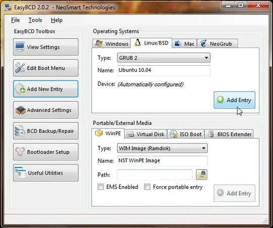

  1. Download Easybcd here. It's a tool that can edit the windows bootloader and it is a very popular program along Windows-Ubuntu users.
  2. Open EasyBCD.
  3. Go to "Add new entry"> Linux/BSD and then select GRUB2 from the dropdown menu. Name the entry whatever you want, like "I love linux" or "Ubuntu GRUB".
That's it! You should see a GRUB entry in the Windows boot menu when you reboot. Select it and choose "Ubuntu generic . . . . . .pae" from the GRUB menu(if the installation failed then you might not see it).

It worked for me. I had installed Ubuntu 12.04 alongside Windows 7. But in boot menu there was just Windows 7. By using easyBCD I have it solved and now I have Ubuntu in boot menu. Notice that I wrote Ubuntu 12.04 instead of Ubuntu 10.04 which is seen above.
