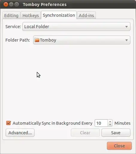

Firstly you should set the synchronization options of tomboy choosing synchronize to local folder.
alt text
Then store your the folder with removable hardware (you can also synchronize to dropbox). Set the tomboy synchronization path again after you reinstall your system to restore your notes.
