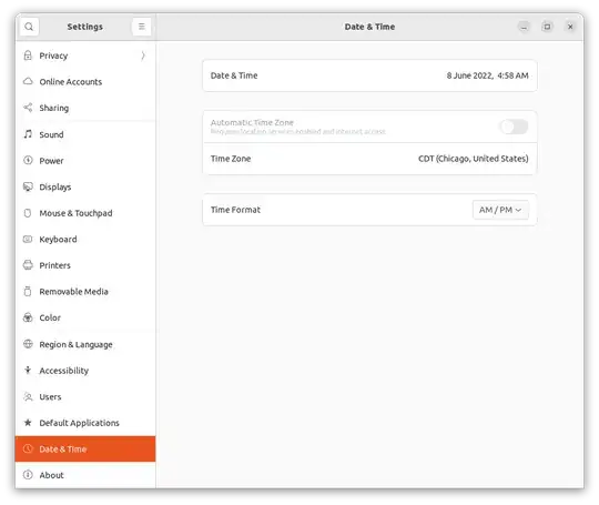

  • Also, because I tried some of those previous solutions, I lost the ability to automatically set date and time, as suggested by the first answer to this post.
Settings's GUI:

  1. MY NTP service is now active again, and the "Automatic Date & Time" switch is once again available in my Settings GUI. This progress was made by referencing this post, since NTP was not supported on my device.

At this point your NTP service should be active again, and the "Automatic Date & Time" switch is once again available in your Settings GUI.
