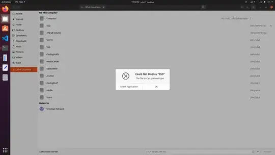

Below are my previous errors in case they matter:
  • Weird error where the path to my dataset located in my nvme drive was corrupted, note the error:
FileNotFoundError: [Errno 2] No such file or directory: /media/hossein/SSE/ImageNdt_DataS`t/trainjn036970p7/n03693007_276q.JPEG
The correct path was
/media/hossein/SSD/ImageNet_DataSet/train/n03697007/n03697007_2760.JPEG
This looked like a memory issue to me, and I thought maybe due to heat, my nvme is going crazy, so after this I installed my nvme drive (samsung 980 1tb) to another slot down the board (previously it was installed between cpu socket and graphics card port which made it very hot around 65/76c). I updated the bios after this.
  • Connection abort error (nvme drive suddenly disappeared(the picture above)):

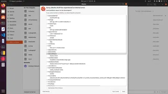

  • another segmentationfault:
Train: 0 [1600/5004 ( 32%)]  Loss: 6.612 (6.85)  Time-Batch: 0.103s, 2492.08/s  LR: 1.000e-01  Data: 0.002 (0.099)
Train: 0 [1800/5004 ( 36%)]  Loss: 6.658 (6.82)  Time-Batch: 0.108s, 2376.50/s  LR: 1.000e-01  Data: 0.008 (0.099)
ERROR: Unexpected segmentation fault encountered in worker.

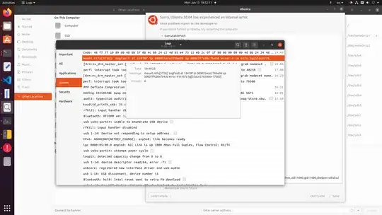

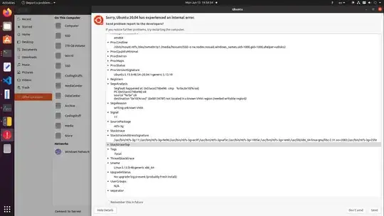

Update 3:
I got some new error logs, this happened today and it seems it has something to do with ntfs-3g: enter image description here enter image description here enter image description here
