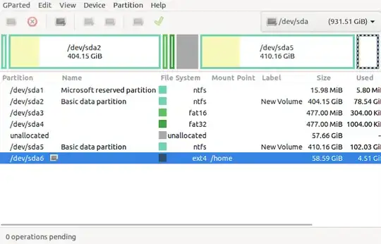

I started using Linux (ubuntu os dual boot) lately and the installation completed smoothly. I allocated the swap and root partition in SSD and the home partition in HDD. After that, I realized the home partition is too small and tried to add more space to it. But I can't do anything with the home partition. It can't be extended from the left and it always says that "the partition is busy".
Here is the HDD structure.
  • The first, second and sixth are from Window.
  • The fifth is the empty space.
  • The last one is the home partition.
HDD structure on gparted
You can only resize partitions that are not currently in use. Thus, shut down the machine, boot a live installation CD and use gparted from a live session. gparted is available by default in a live session, not in an installed instance of Ubuntu.
vanadium
  • 97,564
There is no contiguous space to enlarge the sda6 partition into. You must first move the sda5 partition to the left. This will place the free space next to sda6, and then you can enlarge it.
You must do this from a live session and the partitions to be modified cannot be mounted.
Backup your data before doing this
