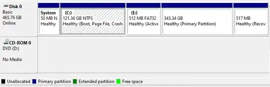

The problem:
I first installed Windows 10. It created the following partitions:
  • System partition (Primary partition).
  • C: partition (Primary partition)
  • Recovery partition (Primary partition).
Then when installing Ubuntu, I tried using the installer's partition tool to resize the C: partition to create a 10GB NTFS partition which would be accessible via Windows and via Ubuntu (I've done this in the past). However, I was informed by the software, that I'd have to create it as (I think) an extended partition. This meant that the 10GB partition would be a logical partition and I'd have to create any extra partitions only within the logical partitions of the extended partition, so I couldn't install Ubuntu into a primary partition. So I rebooted and selected the "Install Ubuntu alongside Windows" option, and did the install. Now I see that there are five primary partitions.
So why am I not allowed to create more than 4 primary partitions, but the system can create how many ever partitions it likes? I don't seem to have any "overlapping partitions" issues as this question mentions.
ps: What I really want now, is to be able to resize the 343GB partition and create a 10GB partition which will be accessible from Windows and from Ubuntu (to be able to share files between the OS'es).

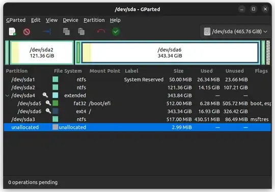

Update: Checked on Ubuntu. So it was indeed an extended partition. Now I'm in a quandry about how to create that 10GB partition that's accessible by Windows and Ubuntu. I used to be able to create it when I was using Windows 8.1 and Ubuntu 16.04.

Edit 1: When you boot from a live Ubuntu system, typically from a USB pendrive, you can run gparted and edit the partitions. If a partition is mounted or 'swapped on', unmount or 'swap off' and it will be available for editing. (Ubuntu cannot let you edit partitions that are used by the running Ubuntu operating system, this is why you should boot from an external drive.)
Finally, it is a good idea to backup everything that you cannot afford to lose before using gparted, because editing partitions is risky, it can destroy the whole partition table.
Edit 2: When running gparted from Ubuntu live in an external drive,
  • right-click on the partition you want to shrink in order to edit, in this case /dev/sda6: the padlock symbol shows that it is mounted, so unmount it.
  • right-click again to shrink it by moving its tail end. (If you move its head end the bootloader may get problems to find it.) Unallocated drive space will be created.
  • right-click on the unallocated drive space to create a partition with the desired file system. I suggest NTFS. Put a label, that makes it easy for you to identify it both from Ubuntu and Windows, for example data.
  • Finally, click on the tick icon to actually perform the operations, and when it has finished, exit from gparted.
