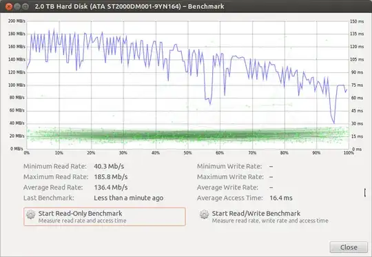

  • Additional: Whether it's normal that reading (and writing as well, I think) speed drops significantly over a minute time; and if it's not, what are some possible ways to analyse/fix the issue?

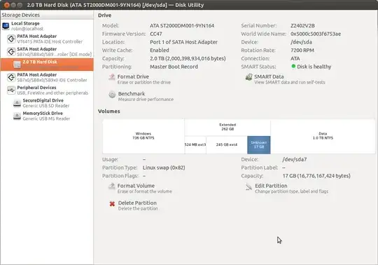

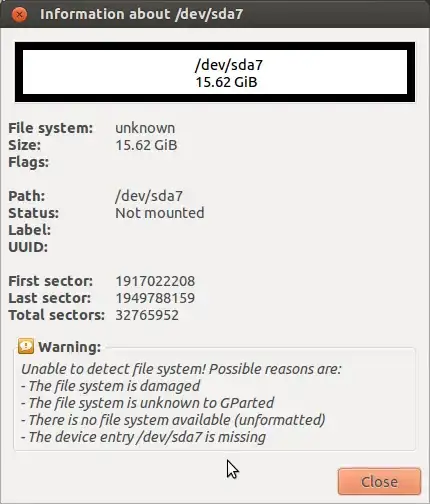

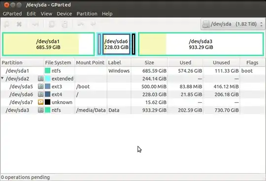

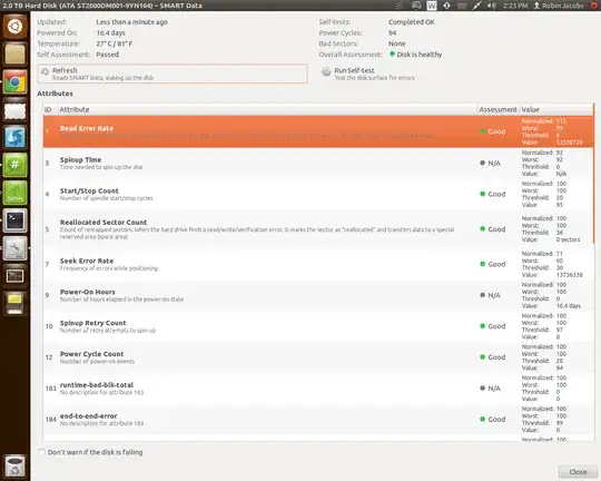

enter image description here enter image description here enter image description here enter image description here
It's a read-only benchmark. enter image description here
The partition labeled Windows holds a Windows 7 installation I'm supposed to need some time for school, and I used before Ubuntu 12.04 got released. I have booted it up a few times after Ubuntu 12.04 was installed (I don't know whether Windows' disk check can do any harm to Linux partitions, but it always seems to run a checkdisk after I changed my partition table layout with a Linux application like GPartEd).

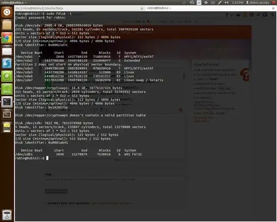

/dev/sda7 is the SWAP partition I'm talking about. enter image description here

Just a shoot in the dark, but IMHO your swap partition isn't damaged at all. I've already seen discrepancies between fdisk and gparted and, it's sad to say, but fdisk is almost always right.
Try a:
#> cat /proc/meminfo | grep -i swap
SwapCached:        10632 kB
SwapTotal:       2094076 kB
SwapFree:        2053324 kB
you should see that your swap space is actually in use (or at least I hope so).
The explaination for that "unreadable" /dev/mapper/cryptswap1 partition is that cryptswap1 is actually a mapped encrypted swapspace, so it should be fine that no one can understand what's in there. If you want to disable it, you can look at this thread: How to disable cryptswap?
Last but not least, your SMART status: at first sight (just watching the read error rate and the seek error rate), I'd have said that your drive was about to melt down. But, no, it's fine, I have a drive whose SMART says exactly the same. I'll post the full output just for reference (both for me and others) for future visits.
#> sudo smartctl --all /dev/sda

And another one with some "real" error, that however is still alive after several months of tiny complaints:

For what concerns the read speed benchmark, I think that a speed decrease over time is normal. I suspect that caching mechanisms make the disk appear faster in the initial phase of testing, and slower at the end. However I see that your "worst" read speed is around 80MB/s that is well above my "best average" read speed (around 60MB/s), so I wouldn't worry about this aspect.

The gparted error is just that it is unable to detect the filesystem (read: it is probably reading the partition data and trying to detect the filesystem type).
fdisk is listing the partition table, just that, and there the entry says it's a swap partition (this has nothing to do with the filesystem, it's the partition type entry in the partition table, fdisk doesn't even try to autodetect the filesystem type).
The fdsik output you show mentions a cryptswap device, which, I assume, is an encryption layer over the swap partition. So that means your swap partition is probably encrypted.
If that's the case, then gparted is reading the swap partition itself, but will probably just find encrypted data that does not seem to be any usable filesystem nor a swap partition, because data there is encrypted and can only be accessed (in its clear, decrypted form) through that cryptswap device.
And if the swap is in use, and the encrypted data is currently being decrypted at the cryptswap device, this also means the partition is in use, explaining the "device or resource busy" error.
Just to check whether this is the issue, can you share the output of running in a terminal /sbin/swapon -s? And perhaps also the content of /etc/fstab?
