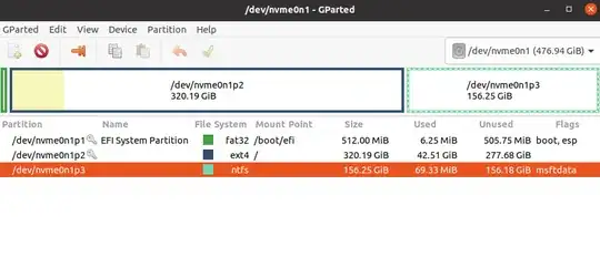

Here's a screenshot of gparted: GPARTED
Only including an image because I can't copy paste it really lol.

WoeUSB is designed to create UEFI bootable USB sticks. Therefore WoeUSB needs to create at least 2 partitions on the target device. This is way the WoeUSB, fails with "... media "/dev/nvme0n1p3" is not an entire storage device!".
If you want dual boot to work, you need to chainload the Windows UEFI boot loader.
e.g. in /etc/grub.d/40_custom add something like
menuentry 'Windows 10' {
    search --fs-uuid --no-floppy --set=root CC66-4B02
    chainloader (${root})/EFI/Microsoft/Boot/bootmgfw.efi
