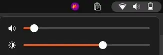

When Ubuntu is run on a laptop, the brightness control allows to simply define the desired level of brightness. This control is not available on a desktop, probably because energy consumption is not considered a problem there.
However, I find it extremely convenient to be able to change the brightness anywhere, if only to reduce eyestrain. I can't find a way to configure Ubuntu to display this control on a desktop.
