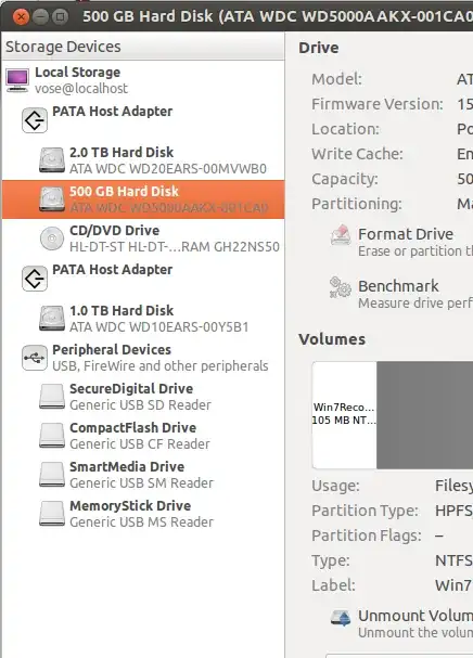

Search for the "Disk Utility" program and open it. Have a look around at the disks on your left, and you should find the disk (or 'partition' if you have windows installed on the same disk as linux) that Windows XP is on.

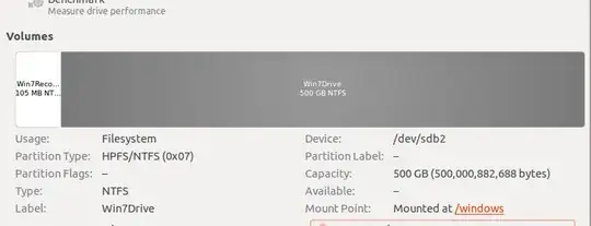

Under "Volumes" select the Windows partition
Screenshot:
And then click "Format Volume". This will wipe out the XP installation, and you can choose to give the drive another name for use in Linux. (By the way, leave "Type" set to "Ext4").
