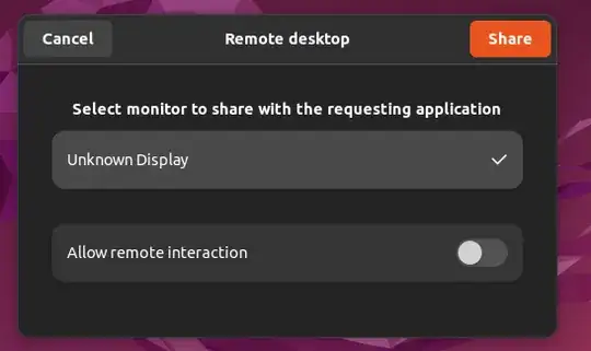

I was trying to setup a remote desktop solution for an Ubuntu virtual machine running version 22.04 LTS, installed on a Mac Mini that I now use as a home server. However, after I installed TeamViewer host and granted easy access, Ubuntu is still prompting for permission each time I try to connect.
The prompt is titled "Remote Desktop" and says "Select monitor to share with the requesting application" with a toggle to "Allow remote interaction."
Does anyone know how to suppress this prompt?
The Prompt In Question

In order to switch to X11:
  1. Edit the gdm config:
    sudo nano /etc/gdm3/custom.conf
  2. Uncomment
    "WaylandEnable=false"
and reboot.
Ali
  • 231
It looks like you need to switch to X11 rather than Wayland for graphics. See this article.
I've just switch back to X11 and logged in without a problem.
