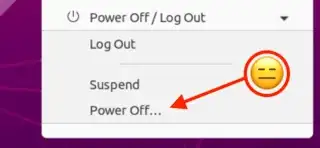

This is one of those times where a UI does not help people get things done. The ellipsis beside "Power Off" is supposed to signify that there are more options when you click it:
Power Off ...

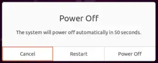

Which leads to:
There they are
There is the option to restart. If you would like to hibernate, this answer will give you the walk-through
