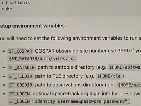

Yeah I was trying to install SATTOOLS by Cees BASSA the other day and ran into a problem. I couldn’t setup environment variables to run SATTOOLS.
In bash or sh, you can set environment variables for the current session (if on the shell prompt) or all future sessions (if in ~/.bashrc) using the following command:
export KEY=value
In your case, you would set ST_COSPAR= something as described in that picture that you linked in your post (that I regrettably can't read due to it being very zoomed in), and the other environment variables as described as well.
This question's answers may help: https://stackoverflow.com/questions/234742/setting-environment-variables-in-linux-using-bash
