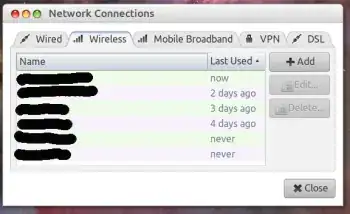

Open Network Connections

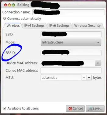

Got to the «Wireless» tab and choose your net. Enter the BSSID. It is something like «00:11:22:33:44:55»
Finally, check the «Wireless Security» tab. The most common security protocol is WEP (Hex or ASCII), but you can try other options.
